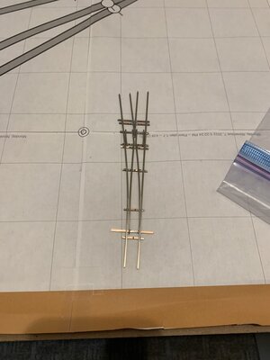

Been awhile since I touched anything model railroading related. Decided to start putting my small room sized layout together. Started with the hidden staging and reverse loop section as it will also support a small hidden work bench foo. Figured I’d give hand laid turnouts a try to see if it was feasible. Id say yes. This was my first that took me 2 hours using jigs and a template. Still need to cut isolation gaps, add ties and a center spring but overall id call this a success so far. True test is how trains roll through.

I haven't cut the isolation gaps into the turnout but plan to. Once isolated, the frog will be power routed with a tortoise or slide toggle switch. The hidden storage will likely be a manual throw via the slide toggle switch.
