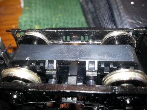

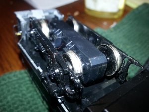

Well, after closer examination I wonder if some thread has gotten wound up in the gear. I used tweezers and pulled some strands off the shaft where it goes in to the gear housing. Any ideas on how to open this gear box?
That depends ... do you want to be able to use it again? :)
Wish I could help but like you, I don't have a clue, at least not a way to ensure that it is reusable.
wombat....those are the very thoughts I was having as I was inspecting it from every angle, even trying to pry and pull it apart. I figured I could get it apart....but getting it back together so it stays together...........?
