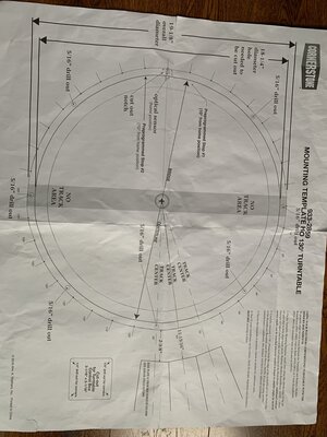

This is the template Walthers includes with their 130’ turntable

Take the two outermost engine bays of the roundhouse. Draw lines, ceter of track out the front doors.
Where the lines cross is the center o the turntable.
That sets the distance.
If you run out of room, you'll need curved tracks between TT and roundhouse.
Bigboy57 - Thanks for that template. Googled for just that and didn't find anything.
So, the template has 10 degree track separation. Using my current drawing ( above ), I have 5 inches of play between the TT and RH. If I go down to 5 degree track separation, the distance between the TT and RH would eat almost all of my play - 4 3/4 inches which means that my drawing is probably close enough for the initial design.
I still have other gimme space - TT can be closer to isleway by a inch or so, my 20in TT diameter can go down somewhat and the 3 corner tracks ( 2 main, 1 yard lead ) can move an inch or so closer to the benchwork edge ( currently 4 inches ).
I see I will need to sharpen my pencil and do the math for the RH door widths and support structure along with getting the coupler to coupler distance of my longest engine ( Bigboy ).

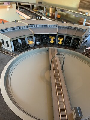

I didn’t have room for the modern roundhouse with the extension for the big boy so I used two of the smaller roundhouse kits and scratch built the middle three stalls for a total of 9 stalls. I have not built doors for the middle three as of yet but I’ll get to it eventually.

Great pix Bigboy. Gave me some reference to what others are doing. I am gonna try for a little more distance between TT and RH ifn I have the room.
I have visited multiple 1:1 TT's and found that there is *usually* parts of the building that have been added after the original building has been built. You will get to the doors don't worry about it. There is no snow around your TT, so it is not cold enough that you need to keep stuff inside warm - right?
Well, I guess I’m modeling mid summer in the Colorado foothills so the snow will never come to my layout but the doors need to be put there. It’s just a lower priority than other things on my layout . The thing about this hobby is that a person is never done…there is always more.
