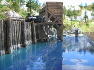

Back on the left side of the layout on the lower level you can see construction started on the ore tipple and the pier. The pier 'logs' are from the park across the street. This plant is lightweight and has much bark definition.
Do to monetary restraints imposed by the CFO around here, almost everything is scratch built on the layout. The ore tipple is NE wood product from my LHS. Paint under the 'water' is acrylics. Lighter toward the shore. Remember this layout is modeled up one of the SE Alaska fjords. So this small water display is the only way to get supplies to the miners. Jim
Here the ore tipple is almost finished. Some weathering and nuts and bolts to follow. The wood is North Eastern wood products from my LHS. I actually had a dull moment and did the inside (never to be seen) of the tipple so it actually works.
Next will be some 'barnacles and sea weed glued down. And of course some woodwork to contain the "water." Jim:)
Jim , that is quite stunning !!!!
Great Scene!
Mike
Just took my first look. Holy crap! Very nicely done sir! :)

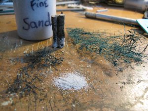

Pictured below are the materials I'm using to have in and around the water. The fine sand is from Lowe's. I found it laying on the ground in the store. You may recognise furnace filter material. I will use this for seaweed. This is a salt water scene so you got to have seaweed. Jim:)

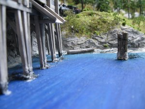

In this photo you can see the 'barnacles and mussels attached to the tipple. Log on the beach and seaweed.

The photo below shows the first pour of Woodland Scenics Realistic Water. I know there are other ways to do this. I've used two-part mixes and Magic Water. All with success. I really don't have a favorite, but I did have the Realistic Water on hand so I used it that's all.
Really it won't matter what type of water I use as this is just 'filler.' I intend to use Modge Podge on top of the Realistic Water after it has dried. I need to create ripples and the Modge Podge takes a bit of the water 'shine' down.
Like it says on the directions each pour is about an 1/8 inch. I let dry over night and pour the next pour. I think four pours should do it. I used some wood I had in the shed for a surround of this water scene. I used Elmer's Wood Glue (yellow) and when dry I caulked the wood meeting edges with clear silicone. I used the No Mildew formula.
This caulking with silicone does a great job filling in the gaps in the wood so the 'water' can be poured and not run onto your floor. Plus silcone is clear as water so no one knows it's there! I've learned my lesson trying to seal water courses. Silicone first is the answer.The cracking you see in the photo is simply air coming up through the wood. With additional pours this is covered up. Jim:)
