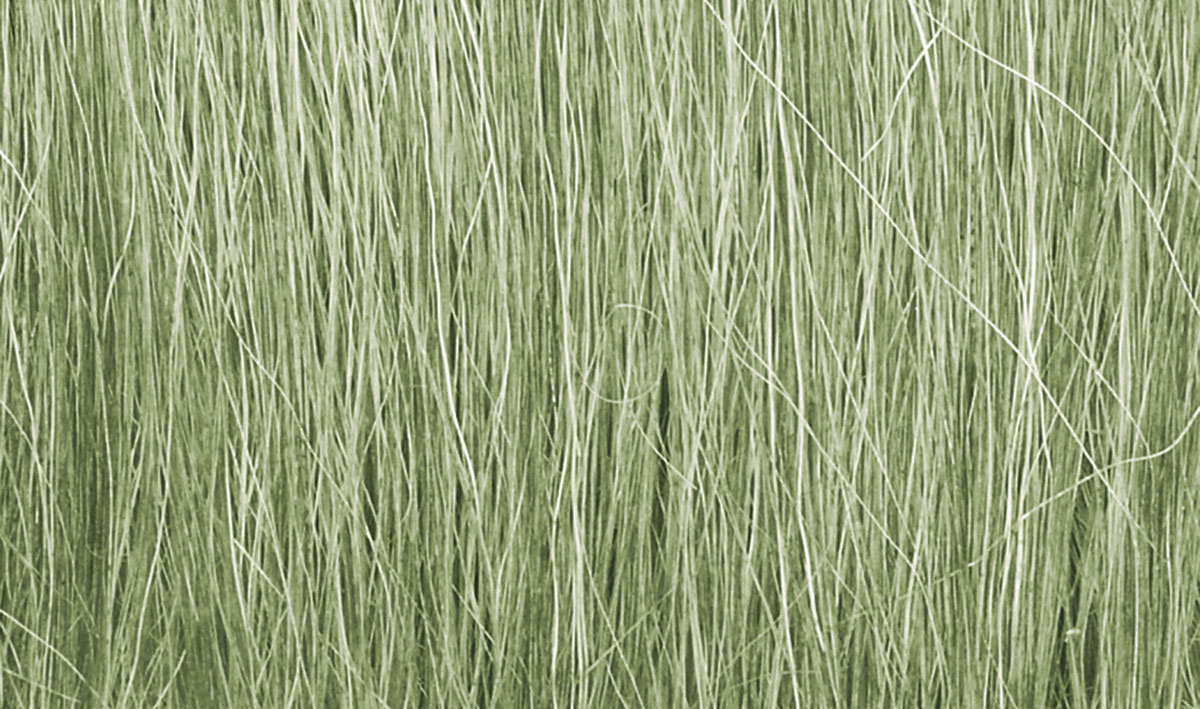

I checked Micro-mark website ( thanks GrampysTrains for the suggestion ) , their bristles look very similar to Woodland Scenics field grass:
I have to order some tools from Micro-Mark and at the same time I'll order their bottlebrush trees items.
