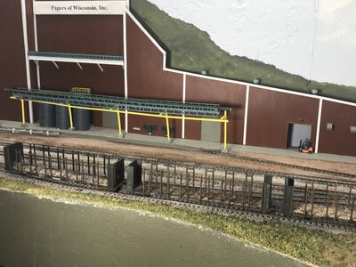

You have seen the trucks and wheelsets. Here is one of the 3 pulp cars to go with them. Questions and suggestions of course are welcome.
One car end, shown above but pictured again below has to be fixed. The white dots, showed up after the last spray of Testors Dull Cote. I will turn those white spots/specks into rust marks and a couple streaks. I have been practicing rust spots on a poor old Athearn Baby high cube from the 70’s.
