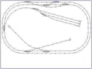

I used SCARM to 'convert' his HO "when we have a bigger house" plan to N scale, and it will fit into a 2' x 4' space. It will need to be stored under his bed. I already have most of the track I'll need.

Measured the actual space we have to store the layout, and we're going with 3x4 instead of 2x4; made some modifications to the layout and it gives us a good 5-6 inches to mount the electrical controls since we're going with old-school DC (Atlas controllers and selectors).

Why not mount the controls on a shelf under the layout? That would free up more space for your trains. I would recommend not filling up the extra space with a lot of track but it would give you a place for some more running. Don't overlook the value of more scenery and the ability to separate sections of the layout from others with the extra real estate.
The purpose of this layout is a summer project for my eight-year-old and I; our home doesn't have enough space for a permanent HO layout, so he rarely gets to use his trains (it requires permission from my significant other to occupy the entire living room with EZ-Track). Since the only place for the layout to be stored is under his bed, it's going to be floor level, on rollers. No space for a shelf for controls underneath.
