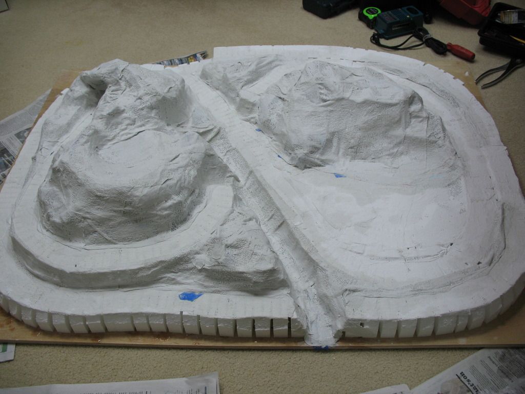

I liked what I saw so I traced the track. The owner didn't want a representation of Iowa, but would like mountains an things. All up to ME.
After tracing I had guidelines for placing the foam. In my mind and on a piece of paper I cannot find now, I laid the foam knowing what I wanted.
Next some plaster cloth over the foam.

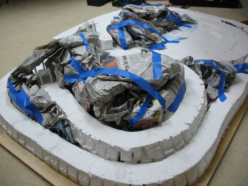

Then because of weight all landforms are newspaper.
Finally plaster cloth.
