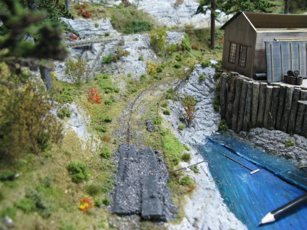

    The first framing was drying over night. Finished this up this morning even with rocks on top. I still need to add weathering, but here is 'desk tunnel.' Jim

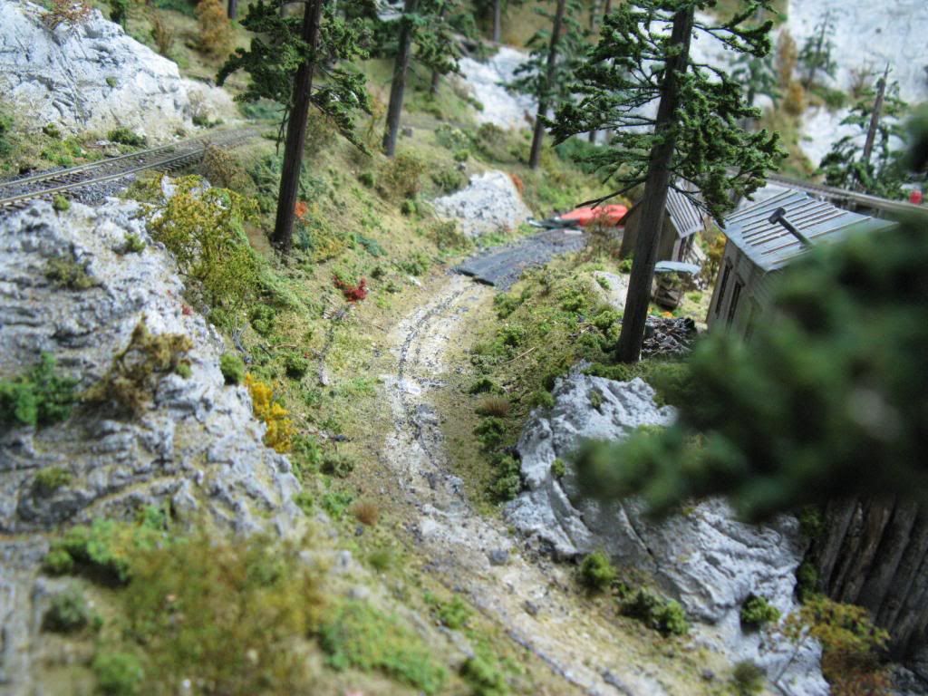

    Here is the photo of the 'desk' tunnel as promised. Since it is only a couple of feet away from me I will keep adding stuff as I go along. Jim

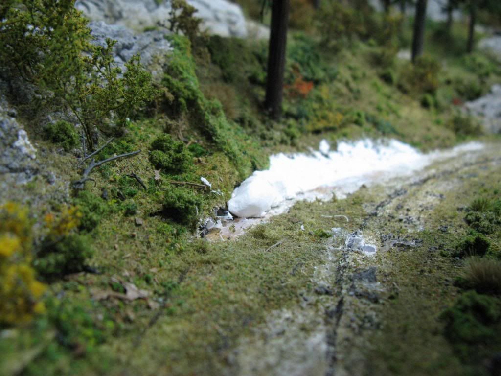

    You sharp eyed viewers can see that the layout is nearly finish at this point. I have to make about 4 more Caspia trees. Speaking of trees. Working on this project working around the tree behind the engine house is not fun. Better testing of the track and train before scenery would have been very handy.

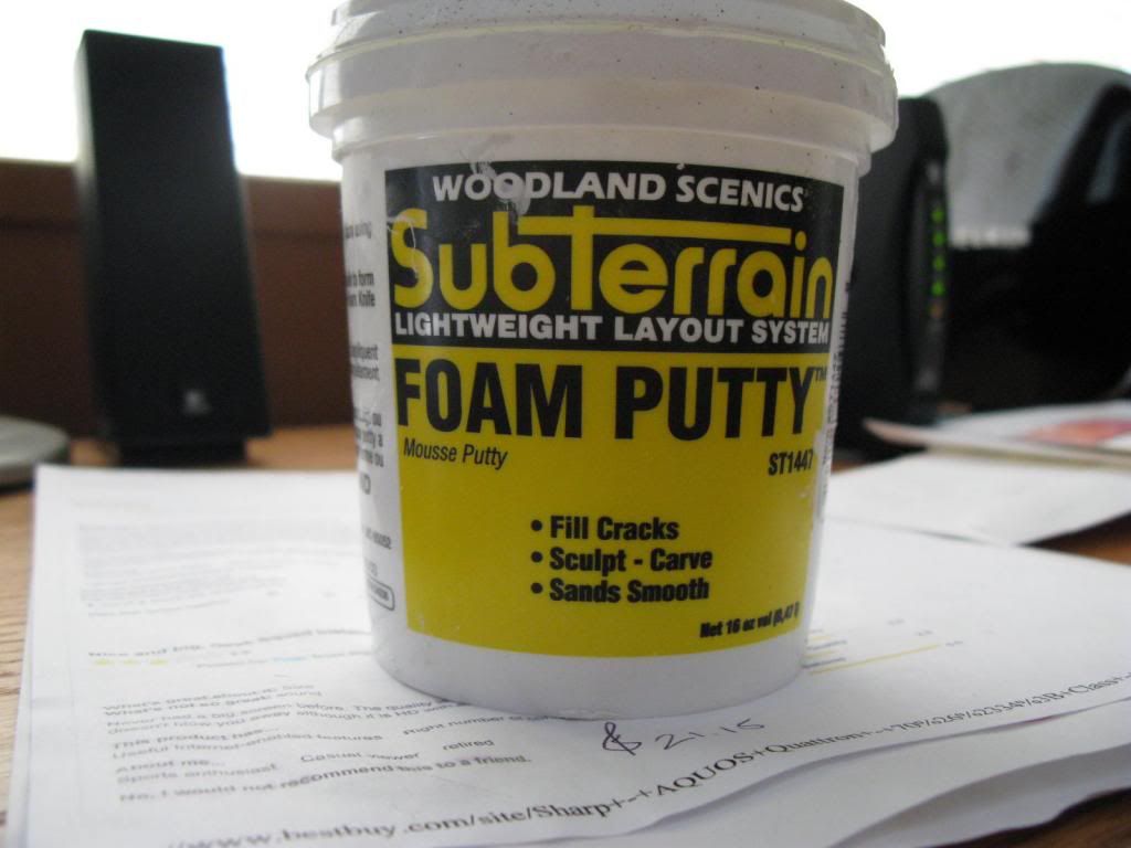

    Anyway, we have to fill this hole. I will use this product:

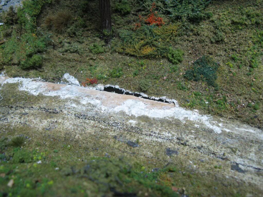

    In this 'fill the gap' scenary pay attention to how I've made a small 'Tootsie-roll' size piece of foam putty. Lay the roll into the gap and spread up the hill first with your thumb. Next spread onto the plywood, in this case, and make sure it sticks. Then you can smooth the middle of the roll.
    I find that this foam putty is the most useful product. It does everything. In fact I will make a small pile of it where the old road bed was and when its dry I will cover that with stucco patch and make a rock outcrop.
    In this last picture I decided to fill in the subroadbed deformities and make it all smooth. You can see two patches. Hope you learned something.
    Jim
