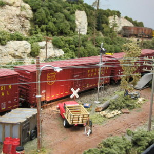

On my layouts I've used Real Dirt by I believe Hi Ball. Or, I have sand from Sedona, Arizona that I used for a county road. I apply it just like any other ground foam, first diluted white glue, apply the material and then wetting agent followed by Scenic Cement.
Fine Cinders from Woodland Scenics works well also.
Greg
Here's a gravel road made from the sand from Sedona. -Greg
