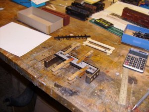

In photo # 1 above, I have used Gorilla Glue to attach the Metal Weight Plate to the Car Floor, using my Nail Guide Pins to make sure of the Weights Plate's alignment to the Car Floor.

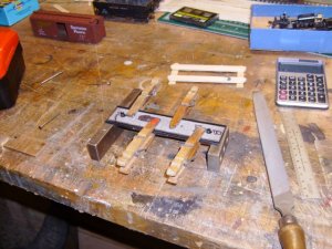

In photo # 2, I am using my Clothes Pin Spring Clamps to clamp the Weight Plate to the Car Floor, while the Gorilla Glue sets-up. I have found these Clothes Pin Clamps to be very handy for all kinds of jobs!
