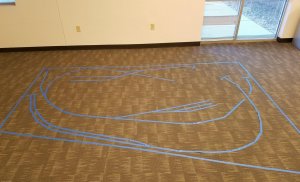

For the designated space in the office I decided on a 9'x12' space that is not a rectangle. Minimum radius is 28". Spent about a month working on a track plan (see thread title beginning with "I stepped in it now"). I wasted about a month thinking we could set a goal for the September board meeting. But nope, and so much for February.
Date Line March 5.
Despite all the best laid plans I wanted to be certain this was really OK with the boss. By the boss I mean the president of the company. After all it is going to be sitting right outside his office door and every client that comes in is going to have to walk by it. So here is the first step. I chose a day I knew he was going to be in the office (which is not often), got masking tape, and marked out on the floor where I intended it to be.

Horseman,
Looks good mate and quite a departure from the original idea's. You should have this up and running by the end of this week, shouldn't you? :)

An abstract shape is definitely more appealling visually, The only modification I would suggest is to make those central sidings longer, by either moveng the first turnout closer to the main past them, or having each as a seperate siding off the main. The latter uses one less turnout and would enable longer trains on each.
Seeing as it's now the middle of this week, Friday of next week will be satisfactory.
