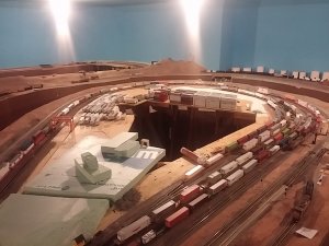

I got some plaster laid down on top of the contoured foam board.
As I have an op session coming up on Saturday, 30 Dec, I have to start getting the layout in order. I placed all the containers and van back onto the container yard. I'll have to go back later and paint the yard concreat color then add the guide lines on the ground for the drivers.
I counted them as I pulled them out of the storage container. A little over 450 containers and vans on the trains and in the yard.
