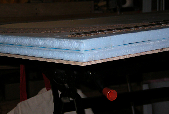

In a similar situation, I glued two layers of 3/4-inch foam to 1/4-inch plywood. Here is the plywood/foam sandwich.

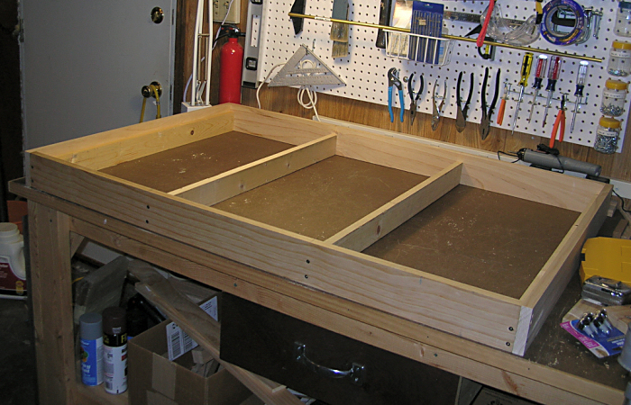

Then I supported the plywood/foam sandwich on 1x3 lumber on 16-inch centers. Here is the benchwork on which the plywood/foam sandwich rests.
