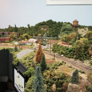

My CM&NR layout also has the typical RIX overpass over the Saxeville interchange yard which I plan to redo and do more realistic weathering for a vintage type bridge that it represents.

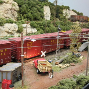

-As an example this road ends at the tracks, but with the Wisconsin Central box car blocks the view no one notices the shortness of the roadway. The right side of the roadway serves the abandoned terminal building. The road was done using sand carried from Sedona, Arizona.
-The road at the left starts at the layout's fascia and ends at the freight yard in the distance. Again the length of this road goes unnoticed. Maybe the amount of detail in this scene hides the fact that this road goes to a dead end.
