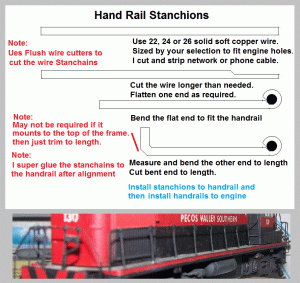

This is the way I have been doing handrails for quite some time now.
