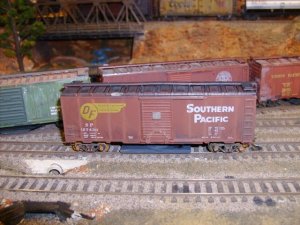

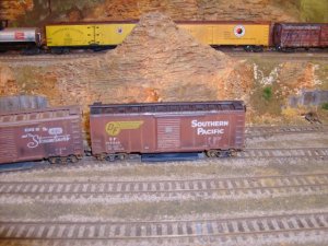

The above photos show the completed and lightly weathered Southern Pacific Box Car Track Cleaner from both sides. I have been having troubles my digital camera as of late. The photo showing the washer I used as weight on the top of the cleaning pad is lost somewhere in the ether! However, you can see the washer in the two photos. Both the pad and the washer have been painted Grimy Black to make them less noticeable.
These photos where mistakenly placed here and should have been put in the thread on making track cleaning cars. Sorry. This car was lightly weathered.

Remember, the name of this thread is: How do you weather your rolling stock? Please describe how you went about weathering your car.
I weathered this one specific car with Acrylic washes and colored chalks. The roof of the car was the same color as the overall car. I used Acrylic Silver to replicate spots on the roof where the paint had pealed off, leaving bear metal and then used a couple coats of thinned Microlux Acrylic Grimy Black to coat the roof, giving it an overall black appearance. The rest of the weathering was done with black, rust and dust colored chalks. Rust was used to highlight the rivet details on the car sides, then black was used along the bottom of the car where dust would accumulate and the dusty color used in the same way. Altogether, I probably took an extra 15 minutes to weather. Although I needed to wait 1 hour between the black washes on the roof.
