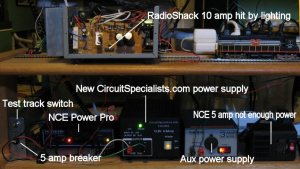

Last year when a lighting strike damaged a few things in the house my $130.00 DCC power supply of 15 years was one of them. Having to buy a new dishwasher etc. I bought a NEC 5 amp 15 volt for $43.00 to replace it only to find out it didn't have enough power to run 3 LokSound decoders in a consist. I thought it was some other problem but found out after buying a Circuit Specialists 6-8 amp for $38.00 the NCE just wasn't up to the task. The Circuit Specialists wasn't only cheap but runs the whole layout without any problems. I did have to pay a $14.00 shipping charge. It does weight 9 pounds. If any one is thinking about buying one I would add a 5 amp breaker to protect the 5 amp command station.

"... I bought a NEC 5 amp 15 volt for $43.00 to replace it only to find out it didn't have enough power to run 3 LokSound decoders in a consist..."
That surprises me a great deal. I was using a standard NCE Power Cab to power around 150 of N Scale track and could run 3 engines on it without an issue. I can't help thinking that there was a problem with something, be it a power issue to the track from the NCE 5 amp or your particular NCE 5 amp itself.
Not suggesting what you did eventually buy isn't good and capable and at 6 - 8 amps it darn well should be. I just think it isn't a case of an NCE 5 amp power supply (general) not being up to the task, rather the NCE 5 amp 15 volt power supply you have/had not being up to the task for some reason.
Anyway, good that you got the problem resolved.

I did every possible test Tony. Two LokSound or TCS sound units ran fine. Every time I added a 3rd they would start causing the command station to act like there was a short some where when there wasn't. I finally decided to try a new power supply and after changing it every thing worked fine. So it had to be the power supply which was not even a year old. If that didn't work I would of had to replace the command station. That's would have been $262.00 for a new Power Pro so I'm glad I only had to spend $38.00.

There wasn't any problem with the layout until I bought a 3rd LokSound and TCS sound decoder. I ran the 3 LokSound decorders in a consist and the problems started. So I thought it was the LokSound decoders. Then I ran the 3 TCS sound decoders in a consist while taking the LokSound decoders off the layout and still had the problem. If I ran any 2 together no problems. Now I'm thinking maybe when the lighting did in my 10 amp power supply maybe it also caused some damage to command station. So I figure it's either the NCE 5 amp power supply I bought to replace my 10 amp or the command station. I bought the $38.00 CiricutSpecalist first because it was the cheapest of the two, hooked it up and everything worked. No more problems. So I don't know. Maybe the NEC 5 amp was bad from the factory. Maybe someone else will have this problem then we'll know.
I am starting to think that may have been your problem. From what I have read, no TCS or ESU decoder draws more than 1 amp per decoder, and that would be very high. Most say they only draw between .35 and .5 amp per decoder. That being the case, you should be able to run up to 10 engines (theoretically) with a 5 amp system. Even the Power Cab Starter System claims you can run up to 4 or 5 engines; although, they don't state with or without sound.
Do you have anything other than your track wired to your main bus wire? If so, is it possible there is something else drawing more power that has resulted in the need to increase your power supply from 5 amp to 6 - 8 amp which seems to have rectified the problem?
It would be interesting to know if trying another 5 amp system caused the same problem. If it did, it probably isn't the system/power supply that is faulty, but more likely 5 amps isn't enough juice to run your layout.

Tony I have the ability to isolate the lower from the upper deck and isolate the two from the test track . My helix can also be isolated being it's independent from both decks. I'll use the NEC 5 amp for something else. I'm not changing anything now that every things working perfectly. I did find a good cheap power supply in the process though.
