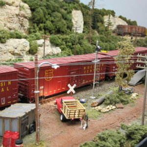

-This roadway ends at the freight yard just beyond the green truck and ends at the edge of the layout.

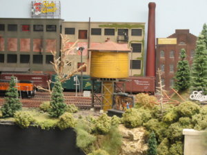

-The industrial area of Waupaca, Wisconsin...is mainly kit bashed background buildings. This scene is barely two feet wide and has five tracks between the buildings and the water tower. I like to "spill" the landscape down the front of the fascia to expand the layout's appearance.
