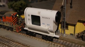

I bought the Sony AS100V camera and built a railcar to push it around on. This youtube clip below is an early attempt to make a good quality video using it. It's a little disappointing so far. I'm hoping someone can make a replacement lens that is much less wide-angle. It would seem that they could offer this with using the center part of the CCD imaging chip and discard the peripheral pixels since they start with over 13-million of them. That would only take a software/firmware update.
https://www.youtube.com/watch?v=-Poa6sUle80&index=1&list=UUkTgEPksvpxNV_CUV2BkHWw

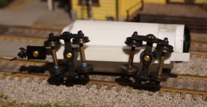

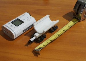

The camera can be operated upside down and the software can flip the image inside the camera. So I took both mounting views on still photos as well as the bottom view. The trucks are old all-metal Central Valley freight trucks.
Here's the car without the "load". The PVC cradle is a piece of 1-inch PVC pie sawed in half. Two half-round strips on the top edges fill the gap and grip the camera in a press fit. A strip of foam on the bottom helps eliminate some bumpiness on frogs and rail joints.

Looks great. For whatever it's worth... i think the width of it is a much more realistic "human" field of perception than if you were less wide angle. Yeah, you can see the ceiling and it didn't help the "illusion" but an awful lot of cab ride videos seem like one is wearing binoculars...
" wearing binoculars... "
Looking through a pair of mailing tubes. :)
Bear in mind that the "target" of this type camera is guys on bikes, surfboards, skis etc... They will spend lots of time swishing their heads from side to side and that can cause some real viewer-nausea unless it is tamed down by a very wide angle.
I doubt anyone at Go-Pro or Sony pictured guys running trains with their camera. Trains make very smooth motions compared to the other uses. I like the Sony because it fits my tunnel portals And, side clearance is no problem either. This is a huge step beyond the one Lionel came out with years ago.
