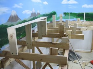

This is my opening thread on the PCM&T. It is a small mining layout in SE Alaska up one of the fjords. It is October 1931. Shown is the woodworking being done over my old N scale layout. This layout will have three levels. The highest level will be reached by a switchback. There will be two mines, a logging camp and a 'Dolley Varden-type' ore tipple. Comments are appreciated. Jim:)
IMG_1085.JPGFolks during the life of this thread many pictures where lost do to mismanagement at Photobucket. I got most of them back and the first third of this site seems to have smaller photos. CLICK on them to enlarge. Learn and enjoy, Jim June 1, 2019 photobucket is at it again trying gouge ever dime they can from us. Now you will see a photobucket watermark on photos they say they own. DON'T EVER USE THEIR SERVICE. It is in no way a service.

Nice that you were able to reuse a lot of the existing benchwork. Backdrop is cool. Looking forward to pics of the screen...

Tim, Yes, I have use WS Foam on all of my layouts. I only used it on this one because it was left over from my N scale layout. I didn't want the subroadbed nice and smooth like the foam gives you. I used risers and plywood this time. I actually want ups and downs and crooked roadbed this time because that models a mining railroad build mostly by hand and mule teams. It is not perfect, but I like the look. HO trains, my Shay, Climax, and Heisler, will run fine on this layout.
Now, if I was building a more modern diesel type layout I would certainly use WS Foam Risers. The system is a great way to go. Thanks, Jim

Rico and Devin, Thanks for the comments. Devin this benchwork is the "L-Girder" type of construction. I like it. Large layouts are probably best done this way. They are other methods but I like this one the best. Jim:)
